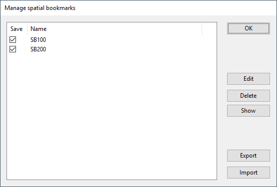

Manage Spatial Bookmarks dialog
This dialog displays a list of all spatial bookmarks for the current network. The status of the check boxes indicates whether the bookmarks are saved to the network or not, (if the box is ticked, the bookmark is saved to the network).
The dialog is displayed by selecting GeoPlan Spatial bookmarks Manage bookmarks, or by double-clicking the network entry in the Spatial Bookmarks window.
Manage Spacial Bookmarks dialog
Item Description
List area
Save The status of the check boxes indicates whether or not the bookmarks are saved to the network. If the box is ticked, the bookmark is saved to the network.
Name The name of the spatial bookmark.
Edit Displays the Spatial Bookmark dialog for the currently selected bookmark.
Delete Without asking for confirmation, deletes the currently selected bookmark.
Show Displays the view extents of the currently selected bookmark in the GeoPlan window.
Export
Displays a standard Windows Save As dialog, for exporting all listed spatial bookmarks to .xml format.
Import
Displays a standard Windows Open dialog, for importing spatial bookmarks from an .xml file.
Caution: Existing bookmarks will be removed prior to import.
OK Closes the dialog.
