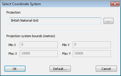

Select Coordinate System dialog
InfoWorks WS Pro has a default coordinate system that is used for all new networks. The co-ordinates entered for network objects are assumed to relate to this system unless you specify otherwise.
Select Set Coordinate System from the GeoPlan menu to display the dialog.
Please refer to the Selecting the Coordinate System topic for detailed instructions.
