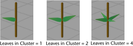

Leaves In Cluster
When leaves are created, they are created in radial clusters at one position around a branch or twig. This setting defines how many leaves are in each cluster.

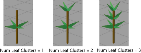

Num Leaf Clusters
Defines the number of leaf clusters created between Leaf Start and the end of the tube or branches.

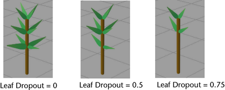

Leaf Dropout
Defines the proportion of leaves that are randomly “pruned” to give a more natural look. If Leaf Dropout is 0, then Paint Effects produces exactly the same number of leaves each time it creates them. If Leaf Dropout is 1, all leaves are pruned.

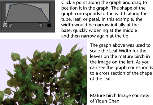

Leaf Width Scale
This allows you to use a graph to control the width from base to tip of leaves, rather than using a simple linear interpolation between two values. When combined with the Mesh BrushType you can define shapes like spheres, as well as control the profile of a leaf. Width Scale is applied as a scale to the current width and defaults to 1.0 so that previous presets work with it.

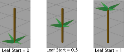

Leaf Start
Defines the point along the tube where leaves first appear. For example, if Leaf Start is set to 0.5, then leaves appear half way up the tube (measured in segments). Decreasing this value pushes the leaves towards the base of the tubes.

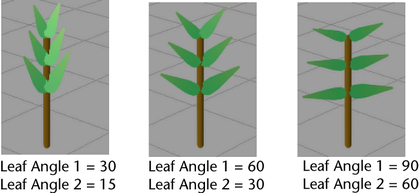

Leaf Angle 1, Leaf Angle 2
These settings define the range of angles that the leaves will make with their source branch. The first leaf cluster created (closest to the root) uses Leaf Angle 1, and the last leaf cluster created (closest to the tip) uses Leaf Angle 2. The angles of the leaf clusters change linearly in between these two clusters.

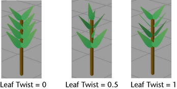

Leaf Twist
Defines how much leaves twist around their source branch. If the value is 0, all the leaf clusters emerge in a straight line along the branch. Positive or negative values make successive clusters emerge from points twisting around the source branch.

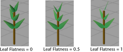

Leaf Flatness
Defines how flat the leaves are. If Leaf Flatness 0, the leaves are tubes. If it is 1, the leaves are completely flat.

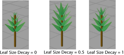

Leaf Size Decay
Defines the size factor applied to each leaf. If the value is 1, all leaves are the same size. As this value decreases, leaves towards the tips of branches are smaller. If you set the value to be greater than 1, the leaves towards the tops are larger
