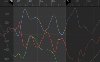

- In the Graph Editor Curves menu, select
- Time Range
Specifies the range of time in where keys are resampled.
- All
Resamples the curve for the entire time range.
- Start/End
All keys within the specified time range (start time/end time) are resampled.
- Time Slider
Resamples the curve for the time range defined by the Playback Start and End times of the Time Slider.
- Start Time
Specifies the start of the time range. This is available only if Start/End is on.
- End Time
Specifies the end of the time range. This is available only if Start/End is on.

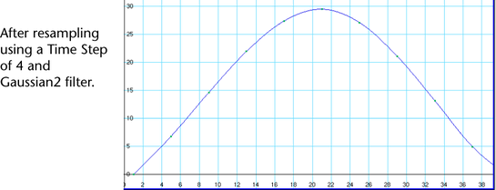

- Gaussian 2
Uses a sloped curve that weights the sampling gently at the top of the peak and toward the edge of the sampled area. This is the default.
- Gaussian 4
Similar to the Gaussian2 filter but with a narrower base.

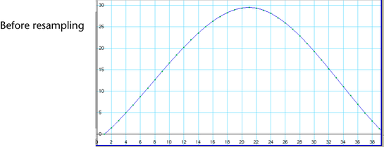

- Time Step
Sets the period for resampling. If you set Time Step to 4, then a key is placed every four frames. Resampling works best when the Time Step period is greater than the frequency of key frames on the curve.
