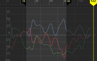

Smooth filter (Gaussian) options

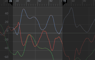

Smooth (Gaussian) filter applied to one channel
The Smooth filter (Gaussian) is similar to the MotionBuilder Smooth Filter in that it averages keyframes to create smooth movement. The Smooth filter (Gaussian) works best when filtering cubic (auto) or resampled curves.
