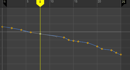

Note: A selection cannot be offset beyond the keys on either side of it. In the following animation, a key originally at frame 8 is offset to 100, but can only move as far as the next frame (frame 13). This is done to preserve the integrity of the animation.
A key offset to a value beyond its range
