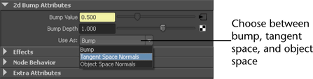

- In the bump2d node
Attribute Editor, choose among the
Bump,
Tangent Space Normals and
Object Space Normals options from the
Use As
drop-down list in the
2d Bump Attributes section.
