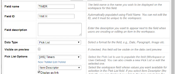

For every workspace that uses the Reminder Utility, a new field on the item details of that workspace should be created labelled “Timer” with the field ID TIMER. This field should reference the picklist [WS Timers] of type Single Selection and be read only.

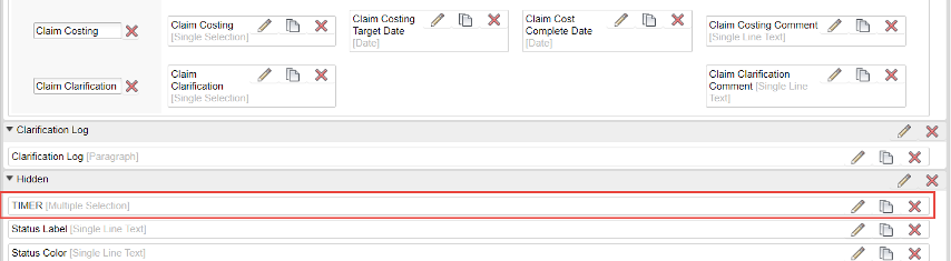

The field can then be assigned to any section in the workspace and even be hidden. The illustration below shows an example of the Claim workspace.
