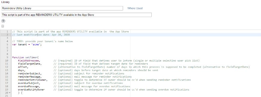

The Reminder Utility Library script contains the function setTimer that can be called with several different parameters. The description of the parameters are described in the function.
As a minimum 2 parameters must be called as in the example in this document. If a parameter is not needed, then it should be replaced with “”
Typical Use Cases
Use Case Details Code
Basic Use Case Send Notifications 1 day before assigned Target Date to selected user setTimer("CLAIM_HANDLER","CLAIM_HANDLER_TARGET_DATE",”,”1”);
Custom Subject & Message Send notification with custom subject & message instead of defaults setTimer("CLAIM_HANDLER","CLAIM_HANDLER_TARGET_DATE",”,”1”, "custom subject", "custom message");
Notify Task Owner If task is due CC task owner setTimer("CLAIM_HANDLER","CLAIM_HANDLER_TARGET_DATE",”,”1”, "custom subject", "custom message",true);
