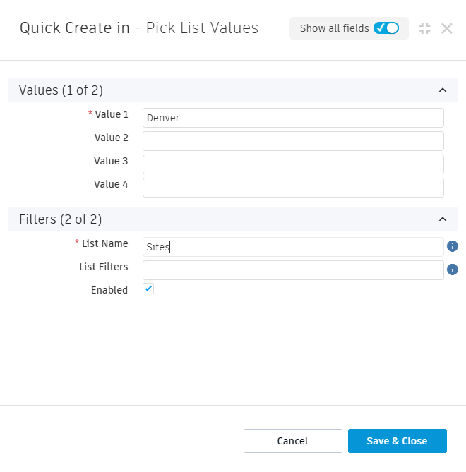

You may create a new picklist value from within the picklist field on the item it's used in.
  1. On the far-right side of the picklist drop-down field, click Create.
    create icon
  2. In the Quick Create dialog, enter a new value in the Value 1 field.
  3. Ensure the Show all fields is toggled on and enter the List Name the new picklist value should be included in.
    quick create
  4. Click Save & Close.
