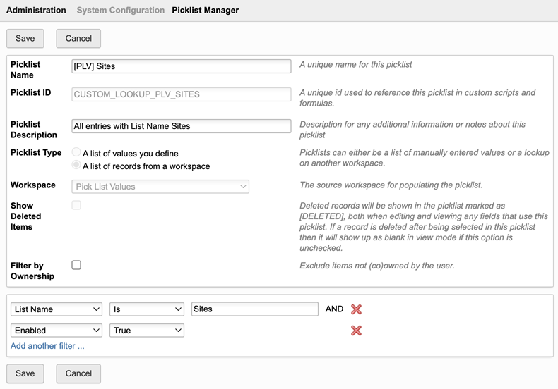

Use the Enable option in the picklist
When defining or editing the picklist, you must add a filter at bottom of the picklist definition that only includes values where the Enabled field is selected.
unselectable
Now, when the Enabled option is unselected for certain picklist value records, the value remains unchanged for existing records but can no longer be selected for new records or when updating existing records.
