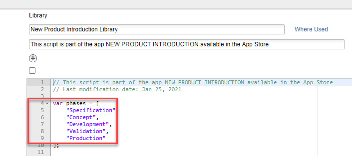

  • Define the phase labels in script New Product Introduction Library:
    alt text

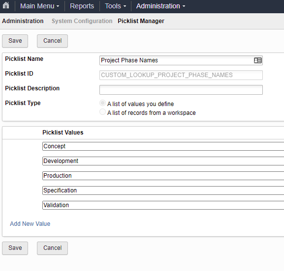

  • Set values of picklist Project Phase Names
    alt text
