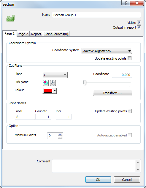

Use the Section dialog to specify the details of the Section group.
To display the dialog, double-click the group's name in the Sequence Tree.
The dialog contains the following settings:
Name — Enter a name for the item. The name is used in the inspection sequence, in the Report and Info tabs, and when referencing the item in other items.
Visible — Select this check box to display the group's inspection points in the CAD view when Section Measurement Display mode is enabled.
Output in report — Select this check box to include the item in the report.
Coordinate system — Select the alignment or datum relative to which you want to measure the group points.

Cut Plane — Specify the plane along which you want to measure the section. To specify the colour of the section in the CAD View and Section View tabs, click the Colour swatch, and then click a box in the palette
  • To use a major plane, select X, Y, or Z in the Plane list, and then enter a Coordinate value or move the slider to specify the point through which the plane must pass.
  • To use a custom plane, click . In the CAD view, click and drag the cursor across the model. The coordinates of the point through which the plane must pass and the vector of the plane are displayed.
    Alternatively, select <Custom> in the Plane list, and then click the buttons to enter the coordinates and vector manually. To inverse the coordinates or vector, click in the edit dialogs.
  • To select a plane, display the plane in the CAD view and click . In the CAD view, move the cursor over the model and click the plane.
    If you select a plane that parallels a major plane, the major plane and coordinate of the point through which the plane must pass are displayed; if you select another plane, <Custom> is selected in the Plane list, and the coordinates of the point and the vector of the plane are displayed.

Point names — Enter a Label, Counter, and Incr to control the naming of points added to the group.
  • Label specifies the prefix or suffix of point names in the group. Enter a percentage sign (%) before the text to display it as a suffix.
  • Counter specifies the first number of the point name.
  • Incr. specifies the increment for the point name. For example, if Counter is 3 and Incr. is 2, the point numbers are numbered 3, 5, 7

Option — Enter the Minimum Points required to measure the feature. The group is treated as unmeasured until at least the specified number of points is probed.
Auto-accept enabled — Select this check box to save the item measurements as soon as you have probed the number of points specified in the Points box. If you played the item as part of the inspection sequence, PowerInspect automatically plays the next item. Deselect the check box to choose how many points to probe and save your measurements manually. This option is available only when an item has no probe path.
