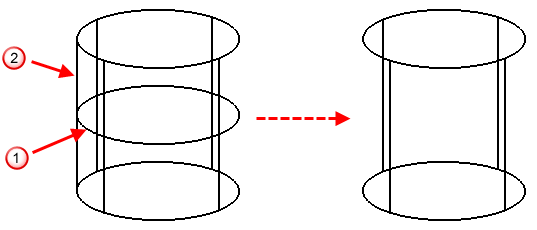

Approximating a surface removes laterals and longitudinals that do not support the surface structure within tolerance.
  1. Select a surface.
  2. Click Surface Tools tab > Fix panel > Approximate.
    In this case, a lateral and longitudinal are removed:
