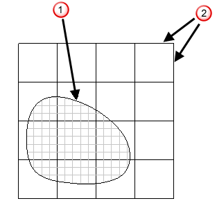

Simplifying a surface removes laterals and longitudinal made entirely invisible by being outside the trim boundaries.
  1. Select the surface. For example:
    Trim boundary.
    Curves outside the trim boundary.
  2. Click Surface Tools tab > Fix panel > Simplify.
    In this case, a lateral and longitudinal are removed:
