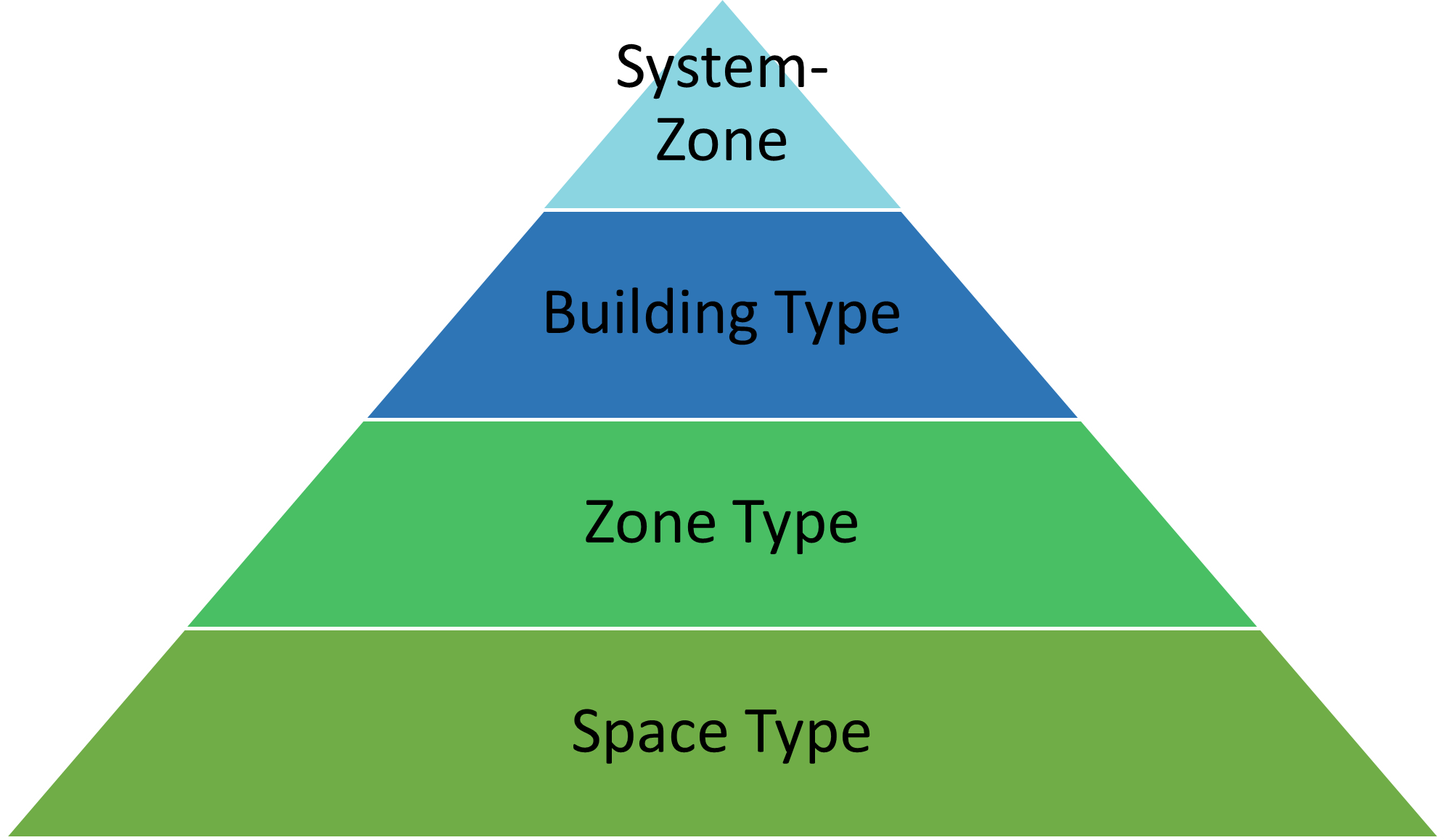

Energy Analytical Model (EAM): Outdoor Air Data settings
Outdoor air (OA) settings are transferred from the Revit model to the EAM based on the hierarchy in the picture. If OA parameters are not specified at the system-zone or object level, the model falls back to the next available level, ultimately defaulting to the System-Zone settings if they are present in the model, otherwise Building Type Settings.
Supported Outdoor Air (OA) methods include:
  • By People and By Area
  • By ACH (Air Changes per Hour)
  • Max (By People and By Area)
  • By Max (By ACH)
  • By Max (By People, By Area and ACH)
Required OA input parameters:
  • Outdoor Air per Person
  • Outdoor Air per Area
  • OA Rate by ACH
Note: If OA inputs are zero based on the OA method, the energy simulation that includes the HVAC simulation factor variation from the base model will fail. Providing valid OA inputs is essential to ensure meaningful HVAC simulation results.
element hierarchy
