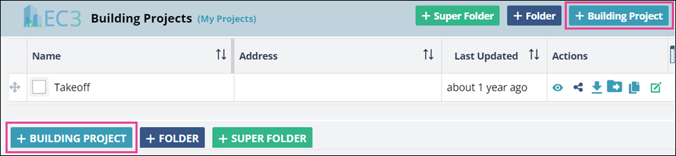

  1. Select Plan & Compare Buildings in the left navigation of EC3 at https://buildingtransparency.org/ec3.
  2. Click a + Building Project button on the page.
  3. Select From Autodesk in the dropdown that opens.

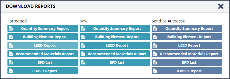

  3. Click Reports at the top right of the quantities table.
  4. Select the desired report template from the Download Reports dialog.
    Reports selected in the Send To Autodesk column will be imported directly to Autodesk Docs on export. See Import a report into Autodesk Docs in this article to learn more.

  1. From EC3, click Reports at the top right of the Quantities table.
  2. This will open a Download Reports dialog, where you can select a report template.
  3. Click one of the report types in the Send to Autodesk column. This will import the report into Autodesk Docs.
    EC3 reports that have been sent to Autodesk and imported to Docs are automatically stored in the EC3 folder in Project Files in Autodesk Docs.
