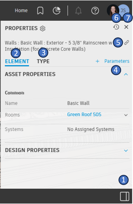

Key Description
1 Footer Navigation - The properties panel can be opened from the right side of the footer navigation.
2 Element Properties – View the properties and custom parameters for the individual asset
3 Type Properties View the properties and custom parameters that apply to a group of identical assets.
4 + Add Parameters – Users can add parameters to an asset, which will also update the Facility Template.
5 Unique URL – Assets/elements each have their own unique URL that can be copy/pasted and then shared.

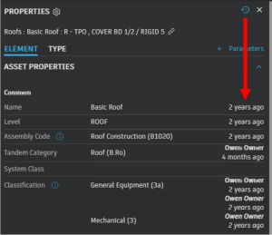

6 View History – View who was last to edit/update the asset details img
7 Close – Minimize the properties panel

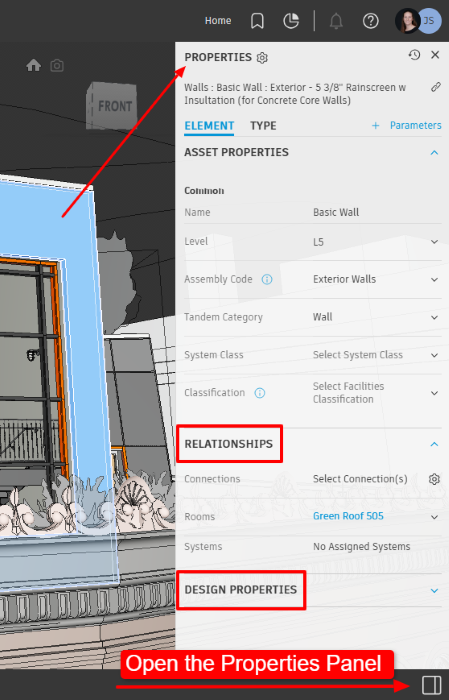

There are several sections in the Properties Panel which organize the asset data. The first section is Asset Properties where custom parameters are grouped by the parameter category.
Next up, the Relationship section details what Spaces, Connections, and Systems that are associated with the asset. In some cases, you may see combined levels here as well.
Then the Design Properties section, which also has properties grouped by parameter category, displays information found in the authoring model. These properties cannot be updated in Tandem. They can only be updated in the authoring model and when it is reimported again, Tandem brings in only the changes made and won’t entirely overwrite what was initially imported in.

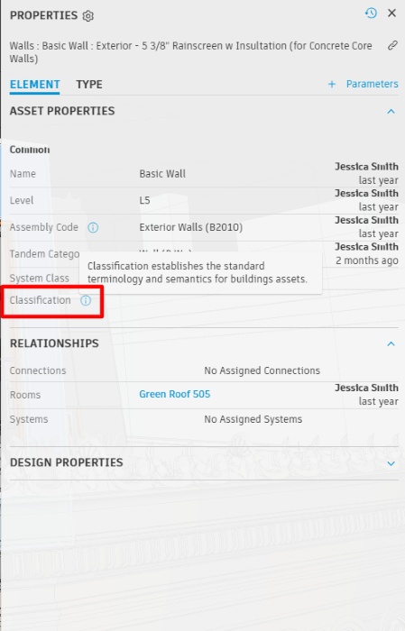

Before asset properties can be updated, assets must be Classified. Once Classified, asset properties can be manually populated/updated in the properties panel. Click in the field to the right of the property name. Then, type or select the asset information.

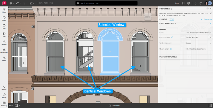

The process is the same for elements with Type properties. The only difference here is that these properties belong to all identical assets. For example, in the picture below, we have four windows of the same type. So, when we update a Type property for the one selected window, we will be updating that parameter for that window and all the identical ones.
