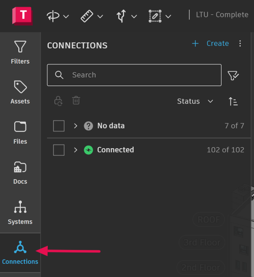

- Open the Connections Panel: Navigate to your facility and open the Connections panel from the left-side menu.

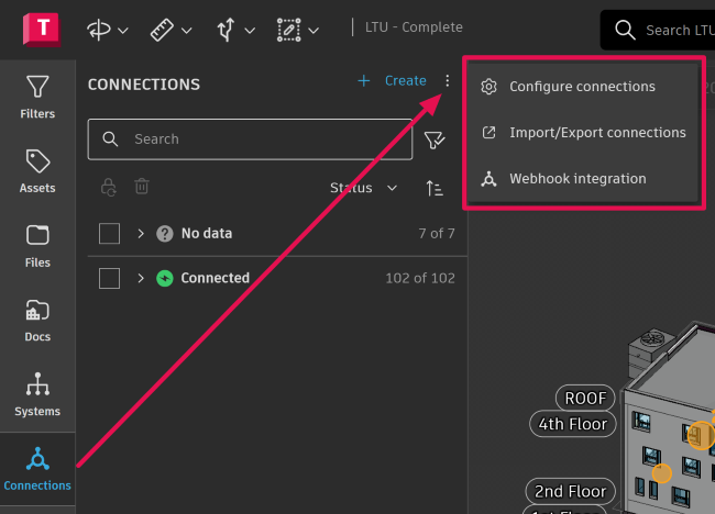

- Configure connections
- Create or update existing connections using the import/export function.
- View or reset webhook integration details for your facility.

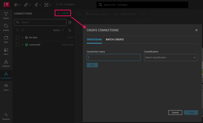

- Create a Connection: Click + Create to start creating a new connection. Choose from two methods:
- Create a single connection manually.
- Batch-create multiple connections for efficiency.

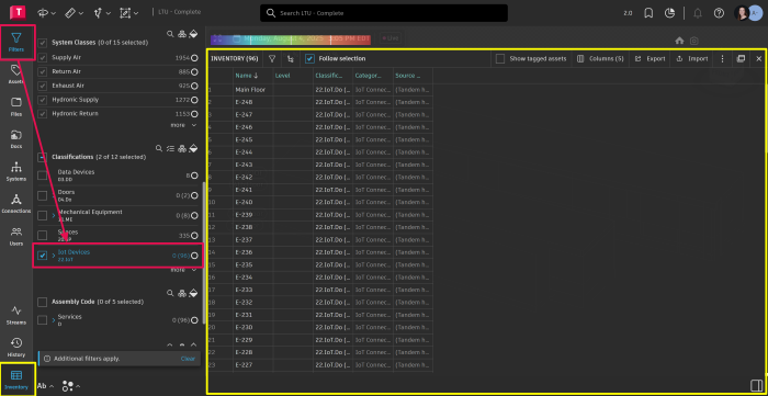

Classify and Define Relationships Once a Connection is created, assign a classification to define the parameters associate to the connection. With the Connection selected, assign it to a host, room, or system, or it can be updated later in the Properties panel.
To view Connections, open the Inventory panel by selecting the appropriate Classifications in the Filters panel. Non-editable properties in the Inventory Panel are grayed out.

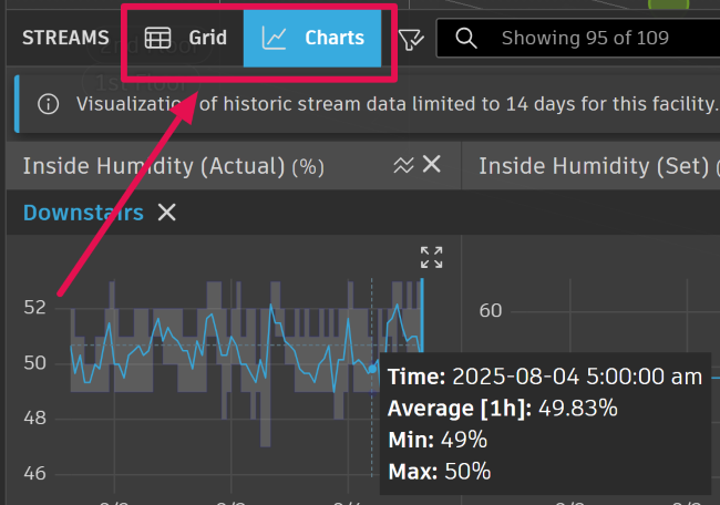

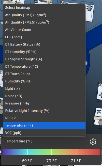

- View Data in a Grid or Graphical Format
- Toggle between a spreadsheet view and a Chart format for detailed facility insights.
- Out-of-range data is color-coded for easy identification.
- *Pro-Tips!**: Customize Threshold ranges to utilize color coding by visiting our Thresholds page
- Utilize Heatmapping by selecting a parameter to apply heat mapping. The viewer will update with color-coded data, which you can adjust to your preference.

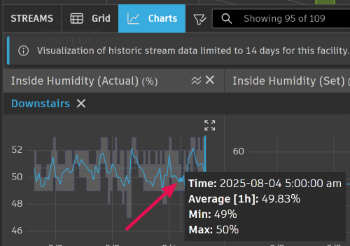

- Analyze Data Over Time by rolling your cursor over the graph to see time-specific details and scroll in or out to view more granular data and insights.
