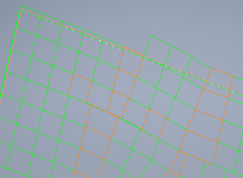

The orange cells in this illustration are examples of wrinkling. Wrinkling is composed of one or both of these characteristics:

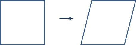

  • Shearing: A cell in the ply is angled to one side.

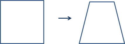

  • Spreading: One or more sides of a ply are compressed or stretched.

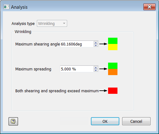

  1. In the TruPlan browser, double-click your wrinkling analysis.
    The Analysis dialog box opens.
  2. Optional: Click the color swatches to set highlight colors; from top to bottom, these colors are used to indicate wrinkling ranges:
    • Acceptable shearing (green in this case)
    • Too much shearing (yellow in this case)
    • Acceptable spreading (green in this case)
    • Too much spreading (orange in this case)
    • Too much shearing and spreading (red in this case)
  3. Set wrinkling values.
    • Maximum Shearing Angle: This is the angle difference between an original, relaxed, material cell and a material cell sheared across the ply surface. Cells with angles higher than this value will be highlighted with the warning color (yellow).
    • Maximum Spreading: This is the calculated percentage change in lengths of the cell borders. Cells whose border length has changed more than this value will be highlighted with the limit color (red).
