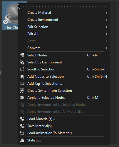

Context Menu
Contains quick shortcuts to commonly used Material Editor functions.
Materials section and Material Preview pane
Right-click in the Material Graph, Tags, or Group Preview to access menu options. Depending on where and what is selected, different options may vary. These options are grouped into creating, editing, selecting, adding, and loading and saving.
Creating
  • Create Material - Creates a material. Choose from a large list of materials. See the Truelight Materials Reference section, for information on each material and its use.
Editing
  • Edit Selection - Accesses a sub-menu with options for copying, pasting, duplicating, and deleting, along with others for pasting attributes and texture size, dealing with inline images sequence, and locking and unlocking materials, as well as the following:
    • Create Light Sources Create Light Sources - Only available when Environment materials are selected. Opens the Create Light Sources from HDR module to add lights to your environment. Once the module opens, click the Create New Light Source button.
    • Boost Light Boost Light - Only available when Environment materials are selected. In some outdoor HDRs, the sun is too dark compared to the sky. This leads to incorrect lighting that's bluish look, with shadows that aren't contrasted enough, etc.
      Use the Boost Light dialog to repair an HDR. All values in the HDR above a threshold (e.g., 95% of maximum value) are scaled up by a user-defined boost. Use this to make the sun brighter, compared to the rest of the HDR.

  • Edit All - Accesses a sub-menu with options for merging, optimizing, and removing. These options are also found in the Edit menu.
    • Merge Duplicate Materials icon Merge Duplicate Materials - Merges materials, based on the option selected in the Merge Duplicate Materials dialog that appears.
      Select one or more options, then click Merge. Locked materials cannot be merged.
      • All (Ignore Names) - Merges all materials, regardless of different naming.
      • With Same Names - Merges only materials that share the same name.
      • Ignore Switch and X-Rite Materials - When checked, switches and X-Rite materials are omitted from the merging, even if they are a duplicate.
    • Remove Unused Materials icon Remove Unused Materials (Ctrl + U) - Removes all unassigned materials from the Material Graph.
    • Reference Unused Materials icon Reference Unused Materials - Creates a reference to any unused materials, so that they are not erased by commands such as Remove Unused Materials.
    • Optimize Textures icon Optimize Textures - Optimizes textures to improve memory performance.
    • Remove All Groups icon Remove All Groups - Removes all material group nodes and places the materials in the top level of the Material Graph.

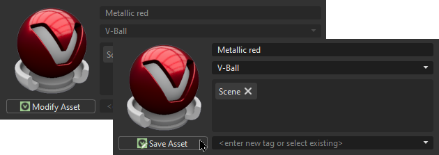

    • Modify Asset icon Modify - Unlocks the asset, so the material and/or material preview can be modified. The referenced asset in the Asset Manager remains unaffected.
      Tip:

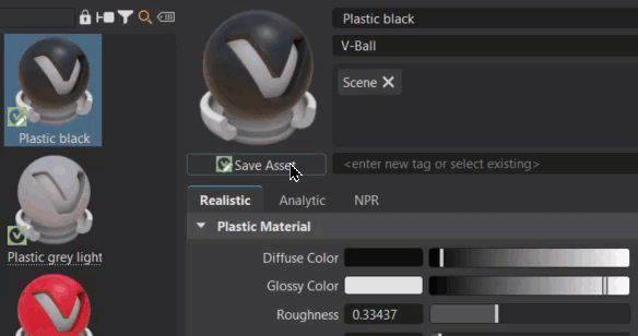

      You can also click the Modify Asset button below the Material Preview.
      Modify Asset button
    • Save in Asset Manager icon Save in Asset Manager - Saves the modified selected asset within the Asset Manager, updating all references. Attributes is greyed out, once saved, and the Save Asset button reverts back to Modify Asset.

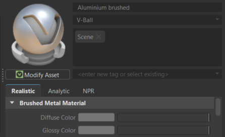

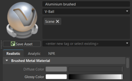

      Before After
      Attributes editable Attributes uneditable
      Tip:
      You can also click the Save Asset button Save in Asset Manager icon below the Material Asset icon.

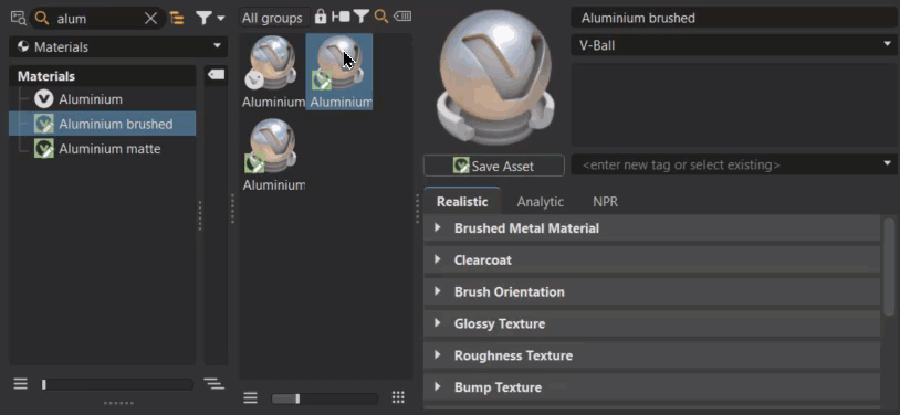

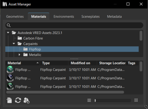

    • Find in Asset Manager icon Find in Asset Manager - Opens the Asset Manager and selects the corresponding folder within the file browser tree inside the Asset Manager's Materials tab.

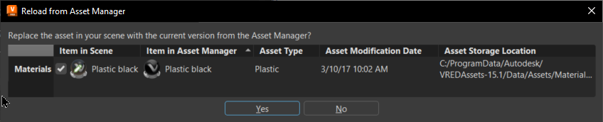

    • Reload from Asset Manager icon Reload from Asset Manager - Opens the Reload from Asset Manager for replacing the asset in your scene with the current version from the Asset Manager.
      Reload from Asset Manager dialog

  • Convert - Accesses a sub-menu with options for converting the selected material into a TrueLight material, Phong Truelight material, Skylight, or Sphere Environment.
Selection
  • Select Nodes Select Nodes - Selects the geometry nodes assigned to the currently selected materials.
  • Select Material Select Material - Only available in the Material Graph. Selects the original material used in the grouped hierarchy (a switch, multi pass, or layered material). Select a child material within a switch, multi pass, or layered material, then right-click and choose Select Material to select the original material.
  • Select all Occurrences Select all Occurrences - Only available in the Material Graph. Selects all occurances of the selected underlined material, expanding group hierarchies and highlighting the parent text blue, to show where a material is used. Now, with one or more materials selected, use Select all Occurrences to select all examples of its or their use.
  • Select by Environment Select by Environment - Selects all materials associated with the selected environment.
  • Scroll to Selection Scroll to Selection (Ctrl + Shift + F) - Scrolls to the selected material. This is useful when working with large lists of materials.
Adding
  • Add Nodes to Selection Add Nodes to Selection (Ctrl + Shift + N) - Extends the selection in the Scenegraph to include nodes with the currently selected material.
  • Group Selection Group Selection (Ctrl + Shift + G) - Only available in the Material Graph. Creates a group from the selected materials, switches, or environments.
  • Add Tag to Selection Add Tag to Selection - Opens the Add Tag to Selection dialog for choosing an existing tag or adding a new one. Enter a tag name and click OK. The tag will be assigned to the material, which can be seen next to it in the Expansion column and in its Tags section.
    Add Tag to Selection example
  • Create Switch from Selection Create Switch from Selection - Creates a switch material node and applies selected materials to it.
  • Apply to Selected Nodes Apply to Selected Nodes (Ctrl + M) - Applies the currently selected material to the selected geometry nodes in the Scenegraph.
  • Apply Environment to Selected Nodes Apply Environment to Selected Nodes - (Only available when Environment materials are selected) Applies the environment to all materials of the selected nodes. This is a quick way to apply the same environment to a part of the model, such as a car exterior.
  • Apply Environment to All Materials Apply Environment to All Materials - (Only available when Environment materials are selected) Applies the environment to all materials in the Material Editor. Material types, such as Plastic, Brushed Metal, and Carpaints, use the environment for image-based lighting. Use the dialog that appears to assign the environment to only materials with a certain name.
    For example, if you select an environment called “Skylight” and enter nothing in the dialog, all materials are assigned the Skylight environment. However, if you enter “Studio”, all materials currently assigned the Studio environment, now are assigned Skylight.
    By default, all materials are assigned the default Environments switch. This means they use the environment that is currently active in the switch. When assigning a specific environment to a material, they will always use that environment, instead.
Loading and Saving
  • Load Material(s) Load Material(s) - Allows the loading of all formats, such as AXF or HDR, using File > Load Materials. You can filter for HDR environment, Substance, X-Rite, and OCS materials. Materials are created using the original filename.
    To create these materials, assign a texture file, like an AXF or HDR file. If you select multiple files containing any supported texture format, the Material Editor will create corresponding materials and assign textures to them automatically.
  • Save Material(s) Save Material(s) - Saves the selected materials to a file.
  • Load Animation to Materials Load Animation to Materials - Applies a saved material animation to the selected material nodes.
  • Statistics Statistics - Shows some important statistics about the materials used within the scene, such as the number of materials and textures and amount of memory used by the materials.
