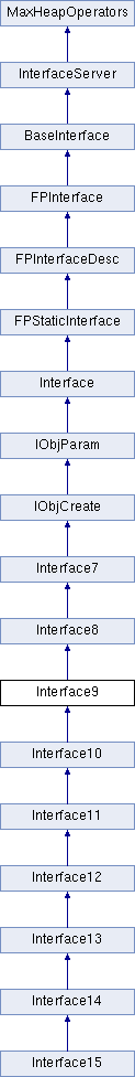

#include <maxapi.h>
The interface class for max version 9.
This interface should always be retrieved over Interface, Interface7, or Interface8 when programming against version 9 of the application. It features new functionality and deprecates obsolete functions.
