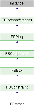

Inheritance diagram for FBActor:Public Member Functions | |
