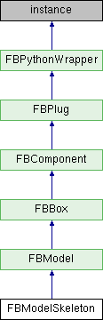

+ Inheritance diagram for FBModelSkeleton:
