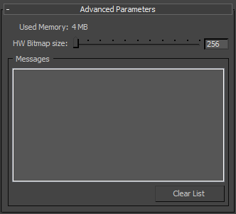

Advanced Parameters Rollout (Vector Map)
Provides some general settings and information for Vector maps.
  • Material Editor > Material/Map Browser > Maps > General > Vector Map > Advanced Parameters rollout
Interface
Used Memory
Shows the amount of memory used for tiles of the rendered Vector map.
HW Bitmap size
Lets you set the size of rendered tiles used in hardware rendering (Quicksilver renderer).
This setting has no effect on the way the Vector map is displayed in viewports.
Messages group
If the Vector map encounters errors while loading or rendering a vector-graphic file, this window displays warnings about those problems.
Clear List
Click to clear the contents of the Messages window.
