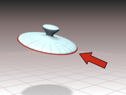

A surface edge curve is a dependent curve type that lies on the boundary of the surface. It can be the original boundary of the surface, or a trim edge.
  • Select a NURBS object. > Modify panel > Create Curves rollout > Dependent Curves group box > Surf Edge button
  • Select a NURBS object. > Modify panel > NURBS toolbox > (Create Surface Edge Curve)
Creating a curve from a surface edge
Procedures
To create a surface edge curve:
    The NURBS object must contain at least one surface.
  1. In the NURBS toolbox, turn on (Create Surface Edge Curve).
  2. As you move the mouse in the scene, NURBS surface edges are highlighted in blue. Click the edge where you want to create the curve.
