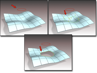

You can use normal projected curves for trimming.
Trimming a surface with a normal projected curve
If the projection intersects the surface in two or more locations, the intersection closest to the seed point is the one that creates the curve.

To create a normal projected curve:
- In the NURBS toolbox , turn on
(Create Normal Projected Curve). - Click the curve, then click the surface where you want the normal projected curve to lie.
If the curve can be projected onto the surface in the surface's normal direction, the projected curve is created. The original, parent curve can go "off the edge of the surface." The projected curve is created only where the projection and the surface intersect.
The NURBS object must contain at least one surface and one cruve.
