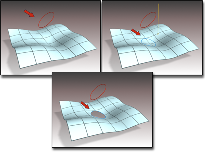

You can use vector projected curves for trimming.
Trimming a surface with a vector projected curve
If the projection intersects the surface in two or more locations, the intersection closest to the seed point is the one that creates the curve.
