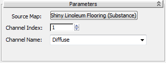

The Map Output Selector map’s simple interface allows you to access the Substance map, change the map channel index, and change the map output channel. For example, you can change the output from Diffuse to Specular while keeping the original connection.

Interface
- Source Map
Shows the name and type of the input map. To switch to this map, click the button.
- Channel Index
The ID number of the output channel from the Substance map. 1 corresponds to Diffuse; 2 to Specular, and so on. This setting is linked to the Channel Name setting (see following).
- Channel Name
The Output channel of the Substance map. Change the channel by choosing a different one from the drop-down list. This setting is linked to the Channel Index setting (see preceding).
You can also change the channel by rewiring the connection using standard Slate Material Editor methods.
