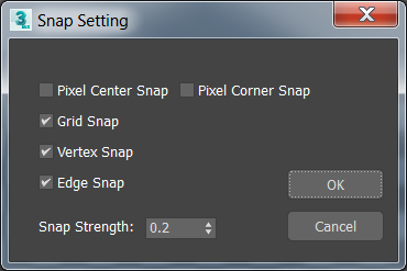

Snaps
The Snaps Toggle
gives you control in creating, moving, rotating, and scaling sub-objects by making the cursor 'jump' to a specific portion of existing geometry or other scene elements when enabled. You can specify where you will snap to using the Snaps Settings
. Any combination of active snap types can be selected to provide multiple snapping points.
- Pixel Center Snap
- Snaps to the center of pixels when there is a bitmap in the background.
Note: With multiple vertices selected, all vertices snap to the nearest pixel relatively, this can slightly alter the spatial relationships among them.
- Pixel Corner Snap
- Snaps to the pixel corner when there is a bitmap in the background.
- Grid Snap
- Snaps to any point on a grid line.
- Vertex Snap
- Snaps to mesh object vertices or objects that can be converted to editable meshes. Snaps to segments on splines.
- Edge Snap
- Snaps anywhere along edges (visible or invisible) or spline segments.
- Snap Strength
- Sets the strength. The default value is 0.2 and range is 0-0.5.
Setting the strength to 0 effectively turns snapping off. At values less than 0.3, grid snapping tends to go to grid edges. At 0.5, grid snapping only goes to grid intersections.
