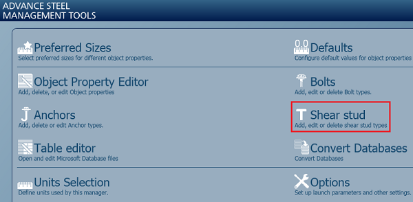

Access the Shear Studs Customization Settings
To access the customization settings for shear studs in Advance Steel:
- Go to the Home tab
Settings panel or to the Tools tab
Tools panel and click
(Management Tools).
- In the Management Tools application, access the Shear studs category:
- Click the arrow next to "Shear stud" to display all the shear stud types and select one from the list.
