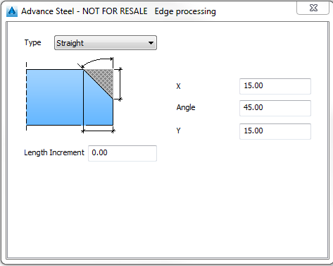

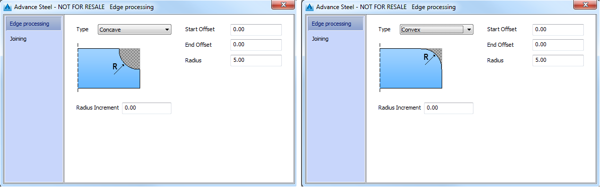

Corner Cut Edge Processing
Type Defines the shape of the weld preparation. The following options are available:
Straight: Creates a chamfered weld preparation.
Convex: Creates a convex fillet weld preparation.
Concave: Creates a concave fillet weld preparation.
Radius Defines the fillet radius.

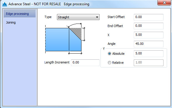

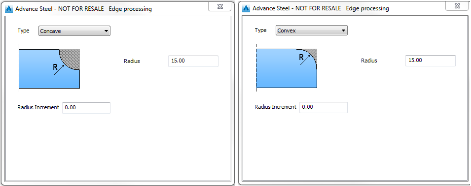

Bevel Cut Edge Processing
