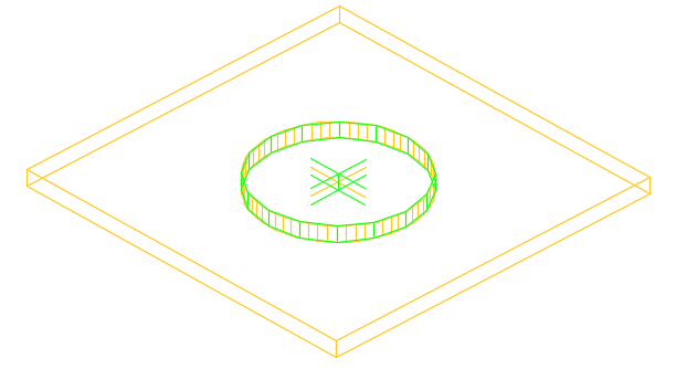

Cut circular contours defined by a center point from a plate.
The cuts can be attached as inner contours as well as outer contours. The rectangle size is set by the defaults.
Access the command
Features tool palette: (Circular contour, center).
Command line: _AstM4PlateInnerContour CIRCLE
Create a circular contour using a center point
  1. In the Features tool palette, click (Circular contour, center).
  2. Select a plate to process.
  3. Define the center of the circular contour to create in the selected plate.
  • The circular contour is created with the default size.
