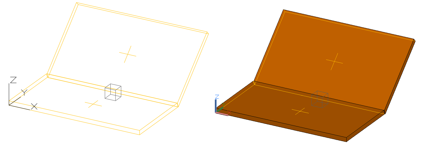

Using this tool you can cut two plates at their bisecting intersection.
Access the command
Features tool palette: (Miter).
Command line: _AstM4CrConByVB
Cut two plates
  1. From the Features tool palette, select (Miter).
  2. In the properties dialog box select the type of chamfer to apply to the plates.
  3. Click OK.
  • The plates are cut.
