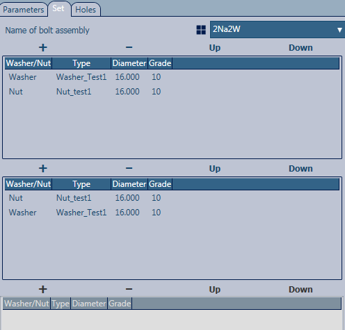

  7. Move to the Set tab and create a new anchor assembly by clicking the New button next to the Name of bolt assembly field dropdown list, type an explanatory name (e.g. 2Na2W, which stands for a bolt set with 2 nuts (N) and 2 washers (2W) and click Apply.
  8. At this point, you can save your new anchor in the database. Click Apply to do so.

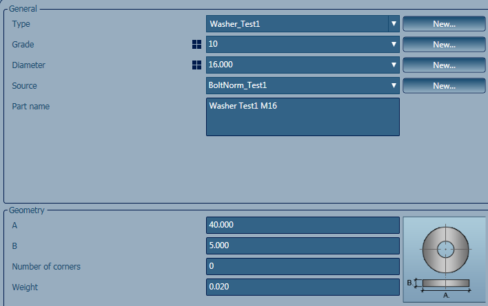

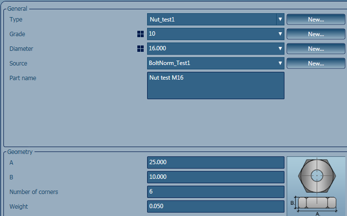

Create new nut and washer types for the assembly
See Create and Customize Nut and Washer Types. The following configuration was made, to suit the bolt that is defined in this example:
  • Nut configuration
  • Washer configuration
Note: The part name is the name used in the Bill of Materials when choosing to have the bolt assembly (2Na2W) displayed into exploded components.
  1. After defining your new nut and washer types, go back to the Set tab of AnchorName_1 and add the nut and washers to your bolt assembly.
  2. In the Set tab, use the plus sign (+) to add nuts and washers to your assembly.
    For this example, one nut and one washer were added for the top part of the anchor and one nut and one washer for the bottom part of the anchor:

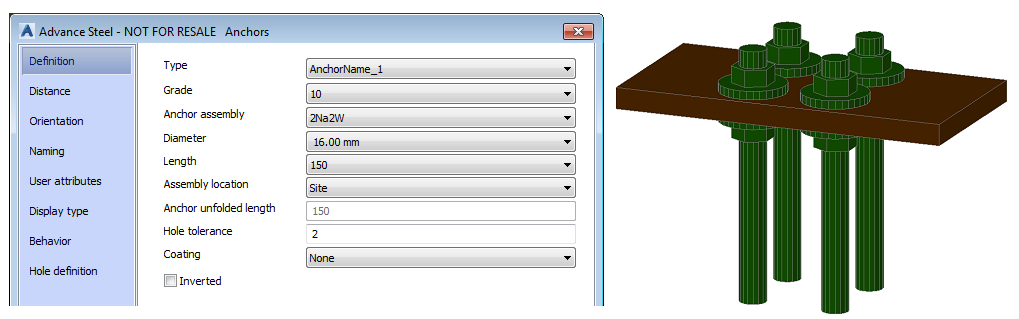

Tip: If Advance Steel was open during the customization process, click the (Update defaults) button in the Tools tab Tools panel to refresh the database to include your new settings.
You can now use your new anchor in the 3D model as needed:
