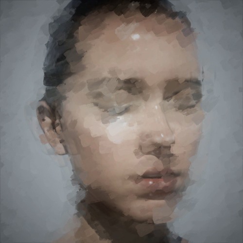

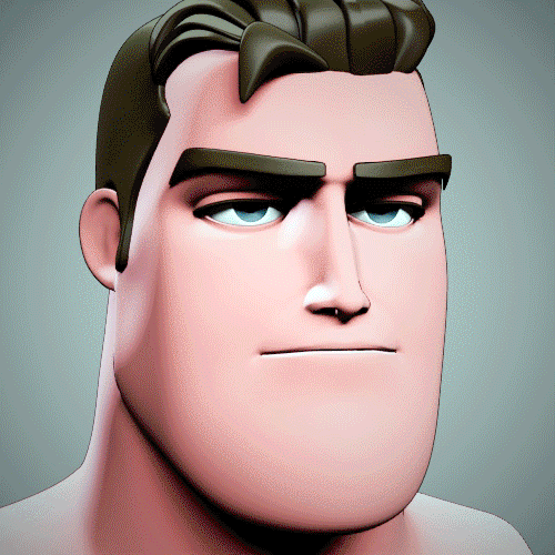

- Shader Imager: The new Shader imager runs a shader network on the rendered image during the imager passes, so you can apply simple compositing graphs and do slap compositing interactively. Add it as a post effect with the Effect button in the Render Settings, or from the Post panel of the Arnold IPR window, and link an Arnold material to its Shader parameter. The network can read AOVs through OSL shaders or an image node, using filenames such as aov:diffuse and aov:albedo. During IPR, editing the shader network linked to the imager reruns the imagers without restarting the render. See Imager Shader in the Arnold documentation. (C4DTOA-3594, ARNOLD-10321, ARNOLD-18335)
| Different OSL-authored styles applied to the same render via the Shader Imager | Painterly brush strokes applied to a portrait render via the Shader Imager |

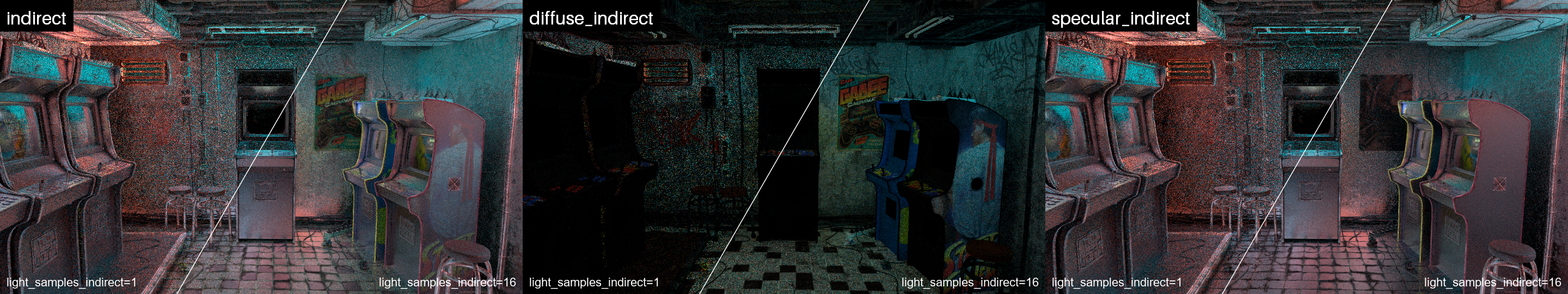

- Control indirect light samples with Global Light Sampling: When Global Light Sampling is enabled, Arnold previously used a single light sample per shading point on indirect (secondary) bounces. The new Indirect setting, under Global Light Sampling in the Advanced section of the Arnold Render Settings, lets you increase the number of indirect lighting samples to reduce noise in scenes with many lights, at the cost of additional sampling. The default is 1, matching the previous behavior. (C4DTOA-3624, ARNOLD-17084)

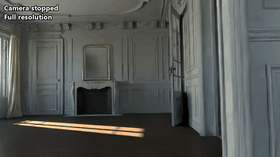

- Viewport render: You can now render directly into the Cinema 4D viewport from the new Arnold viewport menu. Both CPU and GPU rendering are supported. Render progress and status are shown in the viewport HUD, so you can follow the render without leaving the viewport. Choose Settings... in the Arnold viewport menu to open the Viewport Settings, where you can set the Render Device, turn on Accelerated Mode, balance quality against speed with Interactivity, and show or hide the HUD. See Viewport Rendering. (C4DTOA-3636, C4DTOA-3642, C4DTOA-3649)
Accelerated mode: Viewport render supports an accelerated mode. It gives a smoother, more responsive experience, with less noise while you move the camera. You get a usable image sooner and can stay in the viewport while you work on lighting and do look development. This mode has some limitations, for example, imagers are not applied. Turn on Accelerated Mode in the Viewport Settings. (C4DTOA-3638, C4DTOA-3647, ARNOLD-18151)
Responsive navigation: In accelerated mode, when you move the camera, the viewport gets to an interactive frame rate quickly and holds it, then returns to full quality once the camera settles. To keep up, it can drop several quality settings in one step and render at a reduced resolution. These navigation optimizations apply to GPU rendering only. (ARNOLD-18083, ARNOLD-18181, ARNOLD-17770)
| Accelerated rendering (GPU) in real time: the resolution drops while the camera moves and returns to full resolution once it stops. |
A clean, sharp image while the camera moves: In accelerated mode, NVIDIA Deep Learning Super Sampling (DLSS) carries its accumulated reconstruction across camera moves instead of starting over every frame, so noisy scenes stay clean while you navigate. The upscaled image stays sharp, with little smearing and few blotchy artifacts right after the camera moves. Textures look close to their final appearance while they load. Once the camera stops, the Intel Open Image Denoise (OIDN) denoising preserves detail, and the switch from DLSS to the denoised image is smooth. (ARNOLD-18001, ARNOLD-18113, ARNOLD-18197, ARNOLD-18252, ARNOLD-18418, ARNOLD-18401, ARNOLD-18459, ARNOLD-18572, ARNOLD-18608)
CPU rendering in accelerated mode: Accelerated mode also works when you set Render Device to CPU in the Viewport Settings. A GPU device is still required for the viewport processing stage. Without one, Arnold logs a warning and falls back to a normal render. (ARNOLD-18154, ARNOLD-18214, ARNOLD-17853, ARNOLD-18133)

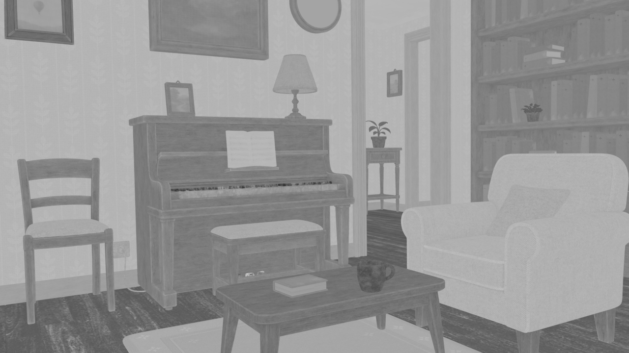

- New built-in roughness AOV: A new roughness AOV reports the surface roughness seen at the first bounce, so you can check the roughness maps across a whole shot at render time instead of building a custom AOV for every material. It is listed with the other built-in AOVs. It accumulates the roughness into a single value, without anisotropy. A material with several lobes returns a weighted average across them, and a surface with no microfacet roughness, and that is pure diffuse, hair, sheen, fuzz, and transmission, returns 1. (ARNOLD-17777)
| Beauty | roughness AOV |
Thanks to Alex Mateo for the use of the Salita scene.
