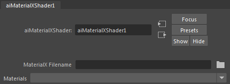

MaterialX Shader - Arnold for Maya
MaterialX shaders (.mtlx) can be opened and a material look applied.
MaterialX shaders (.mtlx) can be imported/exported via the Utilities menu.
MaterialX Filename
The file path to the .mtlx file.
MaterialX documents support relative paths, allowing textures saved alongside a referenced MaterialX document to be easily set. For example:
  • mypath/myshaders.mtlx
  • mypath/dif_texture.tif
Materials
Current material look variant name that should be used from the MaterialX document.
