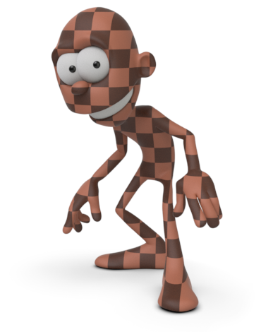

Checkerboard - Arnold User Guide
This shader represents a checkerboard pattern.

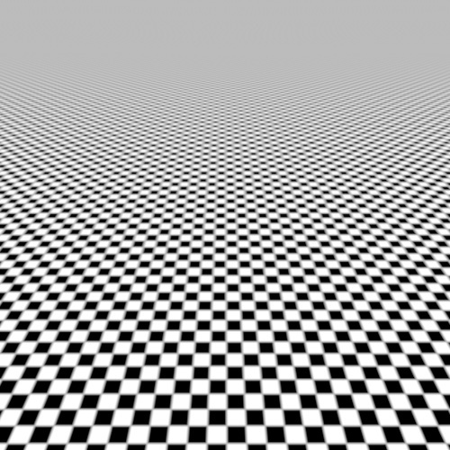

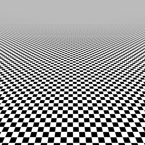

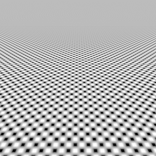

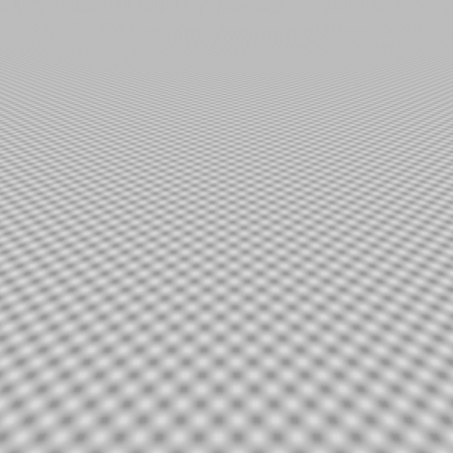

Filter Strength
Specifies the amount used to 'blur' the checkerboard.
| 1 (default) | 5 | 10 |

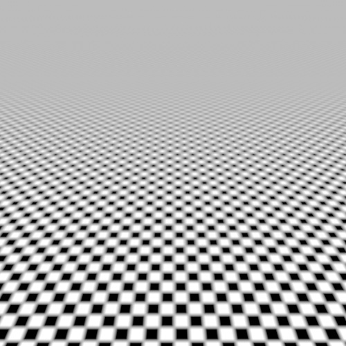

Filter Offset
Scales the size of the filter.
| 0 (default) | 0.1 | 0.2 |
