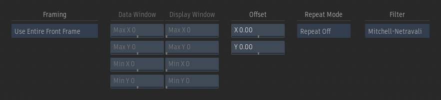

Settings
Framing
Framing option
Select which region of the Front clip is used.
Select: To:
Use Entire Front Frame Sample pixels from the first pixel at the bottom left of the Front clip (0,0) to the last pixel at the top-right (1,1). This mode should be used when:
  • The STMap has the same size as the Front clip.
  • Undistorting a clip with a larger STMap if the STMap’s bottom-left pixel has negative R/G values.
  • Distorting a clip with a smaller STMap if the STMap’s bottom-left pixel has positive R/G values.
Use STMap to Front Ratio Apply a scaling on the Front with a STMap/Front ratio. This result is a Front that is padded or zoomed. This mode should be used when:
  • Undistorting a clip with a larger STMap if the STMap’s bottom-left pixel has positive R/G values.
  • Distorting a clip with a smaller STMap if the STMap’s bottom-left pixel has negative R/G values.
Use Data & Display Windows Use Data and Display Windows information from the STMap. This option should be used when the STMap OpenEXR clip contains this information.
Data / Display Windows option
Select whether the Data / Display Windows information is fetched from an OpenEXR clip connected to the STMap input or are manually set.
The From STMap option works only if a clip is directly connected. This won't work if a node other than a clip is connected. In that case, you can propagate the information utilising the Paste Special workflow.
The Data and Display Windows controls are only available when the Framing mode is set to Use Data / Display Windows.
Not every STMap clip holds this information, but certain applications, including The Foundry's Nuke, are capable of exporting them. An STMap generated from the Lens Distortion node, however, does not include this information.
Offset
Using the X and Y Offset controls can be faster than adjusting the Data and Display windows controls when there are minor tweaks required to fix differences between images.
Repeat Mode
Repeat option
Determine if the part of the image where no pixels appear remain as-is or is filled.
Select: To:
Repeat Off Have parts of the image where no pixels appear remain black. This is the default option.
Mirror Repeat Mirror pixels to fill the black parts.
Tile Repeat Tile pixels to fill the black parts.
Repeat Last Repeat the last pixels up to the edge of the clip to fill the black parts.
Filter
Filter option
Apply filtering to the pixels that moved in the image. Pixels outside the white parts in the clip connected to the Constraint input are not filtered.
Filter Result
Nearest No filtering is applied. The pixel of the texture closest to the screen pixel is displayed.
Linear Basic bilinear filtering.
Mitchell-Netravali Bicubic reconstruction filter designed to minimize reconstruction artifacts. This is the default option.
Catmull-Rom Bicubic reconstruction filter exhibiting a reasonably sharp frequency response.
Anisotropic Non-proportional filtering between X and Y (faster to process than EWA).
Aniso + Linear A combination of Anisotropic and Linear filtering.
EWA A high-quality elliptical weighted average filter that determines the proportions of an elliptical area around every pixel to perform a weighted sampling of the colours (slower to process than other filters).
EWA + Linear A combination of EWA and Linear filtering.
