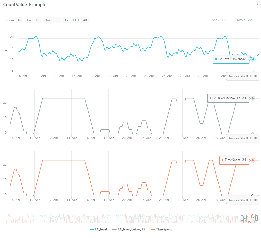

Example chart
This chart shows a level sensor (FA_level), and a calculation of the amount of time (in hours) the level sensor has been below 15 feet (TimeSpent).
It also shows how the TimeSpent function can be replicated using the CountValue function set on an hourly interval (FA_level_below_15).
