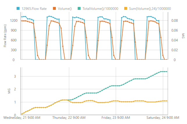

Example chart
The following chart shows the flow rate from a pump station with several functions applied to view the volumes that are delivered.
  • The volume() function shows the volume delivered each time step, which is each hour in this case.
    Note that the results will differ according to the interval selected. That is, daily and 15-minute intervals will report very different volumes.
  • totalvolume() cumulates the volume that has passed through the pump over time.
  • sum(volume(),24) yields the volume that was delivered over just the previous 24 hours.
