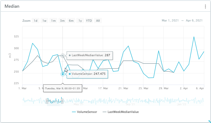

    Median Function
    Calculates the median (middle) value in a set of time series data.
    Syntax
    median(TimeSeries, Period)
    Parameter Description
    TimeSeries A node with time series data.
    Period The number of data intervals considered in the function.
    Example expression
    median(@VolumeSensor, 7): If the interval is set to daily, this will get the median value for the past week.
    Example chart
