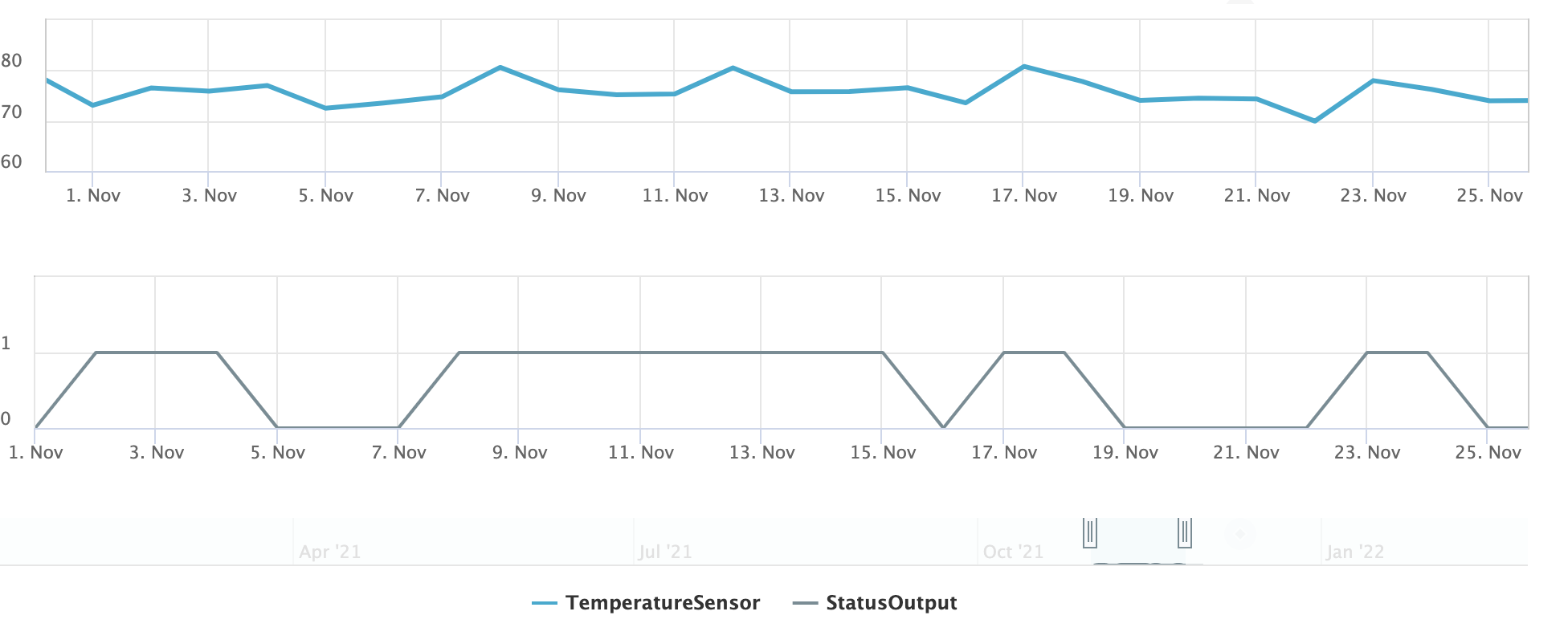

Example chart
This chart uses the If-Then-Else function to track when the temperature sensor is over 75 (true output of 1) or not (false output of 0).
