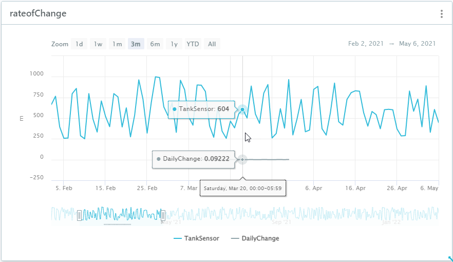

roc(@TankSensor, 2): If the interval is set to daily, this expression will calculate the daily rate of change.
Example chart
