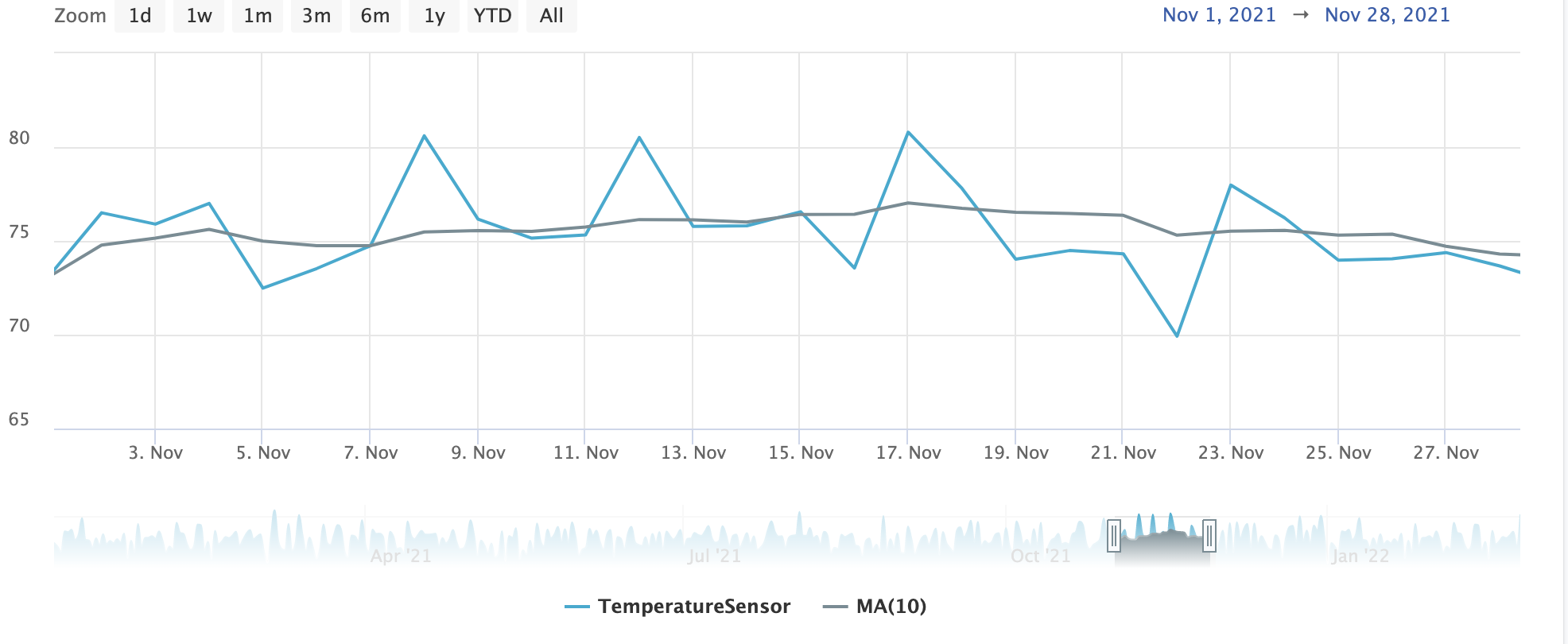

Example chart
This chart shows a comparison of temperature sensor data and the moving average for the last 10 intervals.
