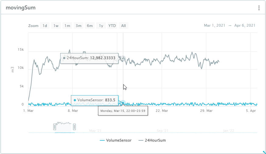

    Example expression
    sum(@VolumeSensor, 2): If the interval is set to hourly, this will calculate the sum of the hourly readings for the past 24 hours.
    Example chart
