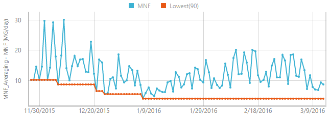

Example chart
The following example tracks the lowest recorded Minimum Nightly Flow over time. Tracking this value is often used as an estimate of leakage in a system. In this case, Lowest(90) will report the lowest close value over the past 90 days.
