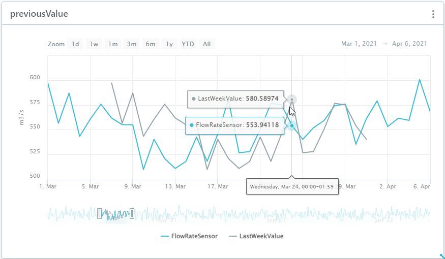

    Example expression
    previous(@FlowRateSensor, 7): If the interval is set to daily, this expression will get the value from the same time last week.
    Example chart
