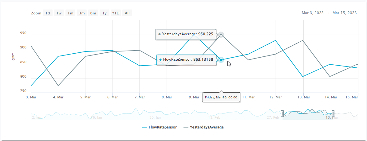

    Example expression
    shiftright(@FlowRateSensor, 1): If the interval is set to daily, this expression will shift the data 1 day to the right. This allows for an easy comparison with the previous day's data.
    Example chart
