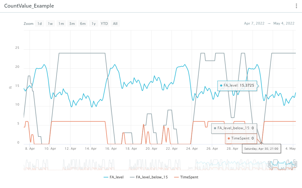

Example chart:
The chart below demonstrates the following expression: countvalue(@FA_level, 24, 15, '<')
It counts the number of times the level sensor dropped below 15 using a 24-hour moving window and an hourly interval.
In this example the TimeSpent function is also shown with an hourly interval set.
